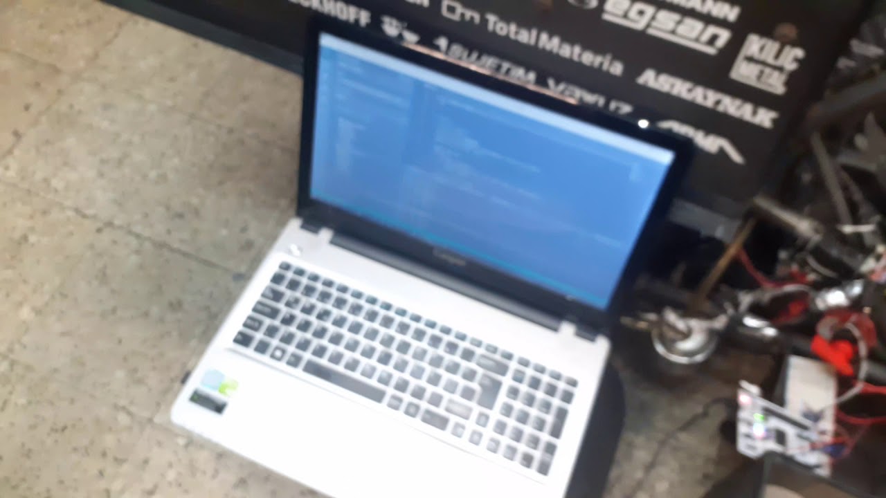

I take a quick video for more explaining my problem.
I can read all data from my car but I cant write on it. I checked adresses and changed them by the way. It is for JohnnyK code. Still, I can read but not able to write. I am trying it almost for 1 mount.
It is better to try it without car (it looks like cool Formule) at the moment.
I see you use two notebooks, do you have connected all ground together? How Zoltan wrote.
In real car are all ECUs, as CAN-BUS nodes, connected to same ground (Car body).
