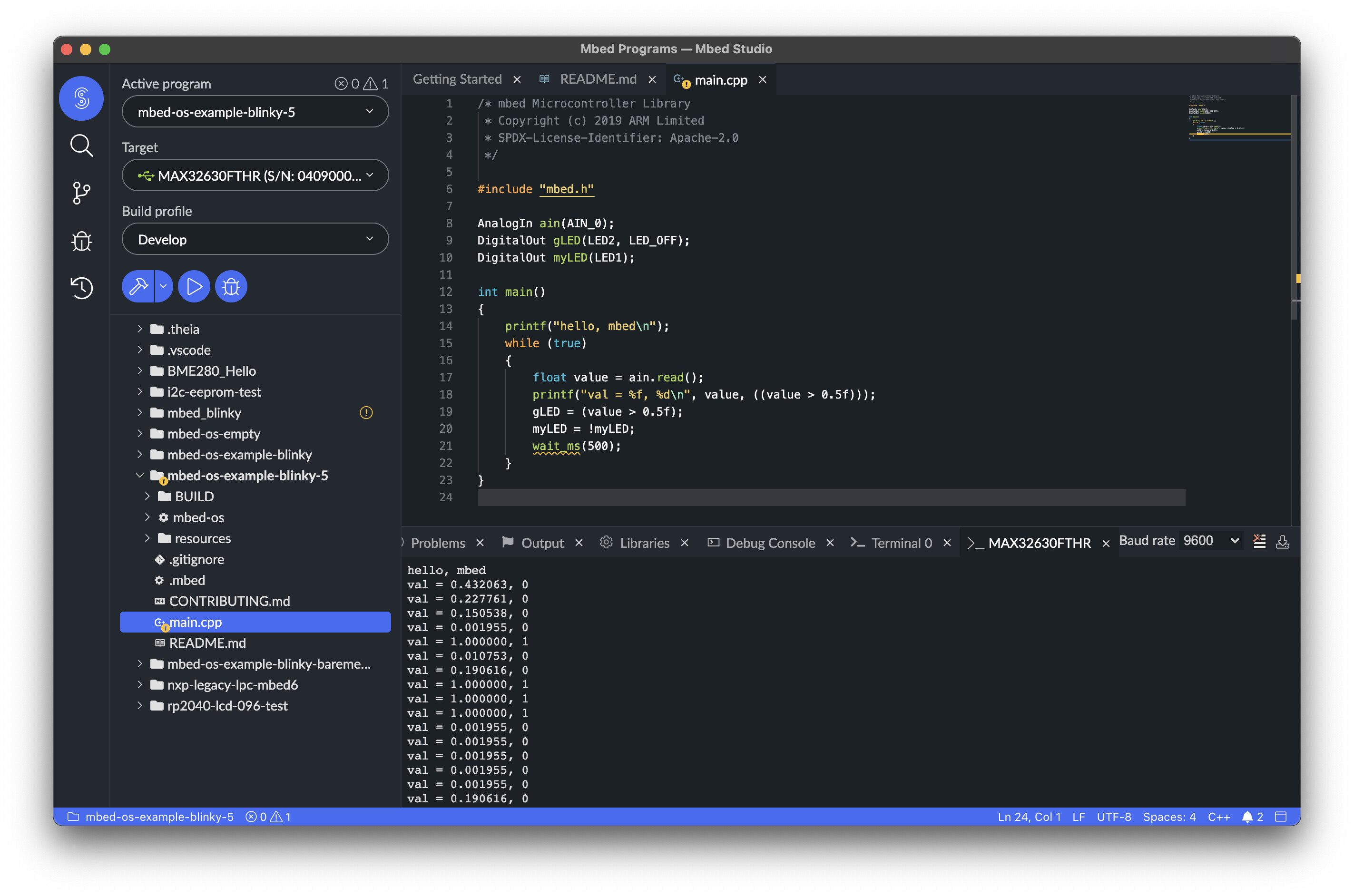

I’ve used the MAX32630FTHR board which I believe it is very similar as the MAX32625PICO board. The blinky example for the Mbed OS 5.15.9 works fine with the Mbed Studio v1.45.
Please see the screenshot below.
I touched/released the AIN_0 port by my finger for the AnalogIn test :slight_smile:
Thank you for testing it with MAX32630FTHR.
I copy-pasted the code you provided me to my mbed studio, and now it worked!!
I really appreciate your advise!
