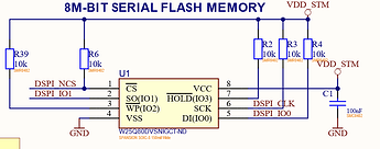

Hello Everyone, I am attempting to integrate with a NOR based external flash storage with mbed os. I am using an STM32F446RC that is attatched to the external flash on the QSPI bus, but should be configured to use either single or dual spi, (4 wires instead of 6).
The Problem
I am having trouble initializing a QSPIFBlockDevice, I am currently passing in the 4 pins I am using and NC for IO2 and IO3. The program halts when trying to map the pins for the device.

In my case, qspi_data_second = -1 due to the two NC pins causing initialization to halt. You cannot set these to random pins either because the pinmap for my device only contains mappings to NC.
My takeaway from this was that the QSPI requires 4 distinct data pins, but my device only supports two so the object doesn’t get initialized.
Essentially I am asking, what is the workaround for this problem? Am I missing extra configuration in my mbed_app.json ? Do I need to directly modify the api or hal files? Am I just missing something extremely simple?

QSPI qspi(PC_9, PC_10, NC, NC, PB_2, PB_6);
 char buf[30];
 size_t size = 30;
 qspi.write(0x9F, buf, &size);
 qspi.read(0x9F << 1, buf, &size);
