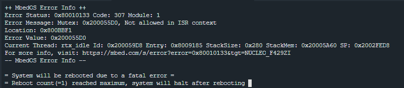

I am having issues with this interrupt, when it is called it keeps recalling and getting stuck in itself
therefor i think disabling from within would be the only solution i can think of. any ideas of how to do this?

Try to publish your code here as formatted text by prepending and appending it with three back-tick characters ``` on a separate line. It will enable people to copy & paste and modify it. A picture does not allow that.

Hi Zoltan thanks for the advice however it throws the same error so am unsure how to solve this is the interrupt cannot be solved within itself.

Because Mbed OS 6 doesn’t allow to use the device in ISR context one option is to use EventQueue rather than ISR. To save RAM you can try to use application’s shared event queue:
