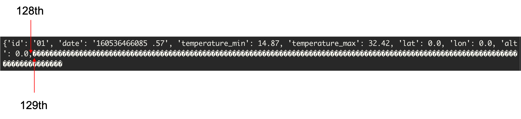

uchiy1320
(Keigo Uchiyama)
December 9, 2020, 11:43am
7
Thank you very much for kind reply, BR, Jan.
I have tried to do based on your advice as slave as Arduino Nano Every and master as MAX32630FTHR. It’s i2c ommunication properly . However, Communication exceeding 128 bytes happened character corruption.
Below are the errors at that time. (Screen Commands)
I want to communicate beyond 128 bytes, is there a better way?
main.cpp (MAX32630FTHR)
#include "max32630fthr.h"
#include <stdio.h>
#define SDA P5_7
#define SCL P6_0
MAX32630FTHR pegasus(MAX32630FTHR::VIO_3V3);
I2C i2c(SDA, SCL);
printf("---------------------------------------------------\r\n");
int ArduinoAddress7bit = 0x08; //arduinoIDE内のarudinoのアドレス
int ArduinoAddress8bit = ArduinoAddress7bit << 1; // ArduinoAddress7bit * 2 mbed内のarduinoのアドレス
printf("ArduinoAddress8bit : %d\r\n", ArduinoAddress8bit); // 0x08なら16
int val;
int key;
printf("I2CProgramm Start\r\n");
char buff[256];
while(1) {
key = getchar();
printf("input key:%c\r\n", key);
i2c.read(ArduinoAddress8bit,buff,sizeof(buff));
//printf("%d, ",buff[0]);
//printf("%d \r\n",buff[1]);
printf("%d \r\n", sizeof(buff));
printf("%s \r\n", buff);
wait(1);
