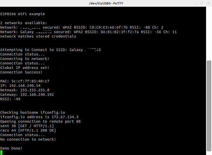

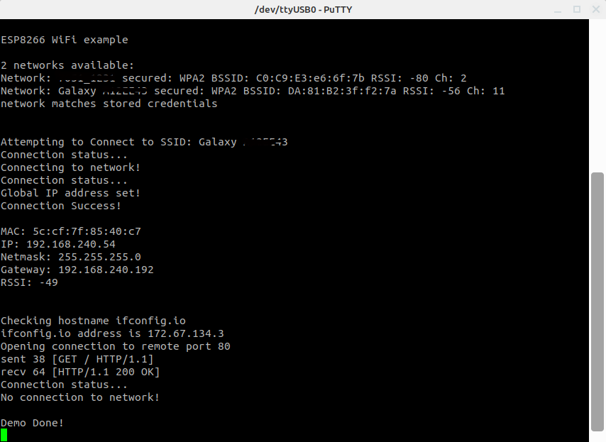

The problem I am having is that I am having little success connecting my humble ESP8266-07 module to my router.
When using the standard WiFi example, as referenced below, I get the scan results without problem.
Early on, I had a spot of beginners luck and had 1 successful connect using the example provided in the WiFi documentation, where I received the IP address and the rest of the connection parameters etc: Wi-Fi - API references and tutorials | Mbed OS 6 Documentation
But now I am at a loss after the nth failed attempt.
