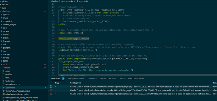

This is my 2nd try to run MbedCE. I installed everything by the instructions. But got this error in the
VSCode.
Surely, path to the toolchain is in the environment.
Any idea?

I can’t get arm toolchain to appear here.
I clicked both: search for kits and unspecified.
[main] Configuring project: mbed-ce-hello-world
[proc] Executing command: “C:\Program Files\CMake\bin\cmake.EXE” --no-warn-unused-cli -DCMAKE_BUILD_TYPE:STRING=Debug -DMBED_TARGET:STRING=NUCLEO_F303RE -DUPLOAD_METHOD:STRING=MBED -DCMAKE_EXPORT_COMPILE_COMMANDS:BOOL=TRUE -SC:/Git/mbed-ce-hello-world -Bc:/Git/mbed-ce-hello-world/build -G Ninja
[cmake] Not searching for unused variables given on the command line.
[cmake] – The C compiler identification is unknown
[cmake] – The CXX compiler identification is unknown
[cmake] – The ASM compiler identification is unknown
[cmake] – Found assembler: arm-none-eabi-gcc
[cmake] CMake Error at mbed-os/tools/cmake/app.cmake:34 (enable_language):
[cmake] The CMAKE_C_COMPILER:
[cmake]
[cmake] arm-none-eabi-gcc
[cmake]
[cmake] is not a full path and was not found in the PATH. Perhaps the extension is
[cmake] missing?
[cmake]
[cmake] Tell CMake where to find the compiler by setting either the environment
[cmake] variable “CC” or the CMake cache entry CMAKE_C_COMPILER to the full path to
[cmake] the compiler, or to the compiler name if it is in the PATH.
[cmake] Call Stack (most recent call first):
[cmake] CMakeLists.txt:12 (include)
[cmake]
[cmake]
[cmake] The CMAKE_CXX_COMPILER:
[cmake]
[cmake] arm-none-eabi-g++
[cmake]
[cmake] missing?
[cmake]
[cmake] variable “CXX” or the CMake cache entry CMAKE_CXX_COMPILER to the full path
[cmake] to the compiler, or to the compiler name if it is in the PATH.
[cmake]
[cmake]
[cmake] The CMAKE_ASM_COMPILER:
[cmake]
[cmake]
[cmake] missing?
[cmake]
[cmake] variable “ASM” or the CMake cache entry CMAKE_ASM_COMPILER to the full path
[cmake]
[cmake]
[cmake] – Warning: Did not find file Compiler/-ASM
[cmake] – Configuring incomplete, errors occurred!
