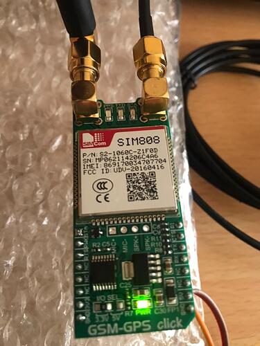

Make and share a picture of your wiring and try to check the status leds on the module.
Kindly find them attached please.
By the way in case you can’t see it clearly , I have connected the RX of the module to D2 and TX to D8. I tried to mixed them as you suggested previously as well meaning ( RX to D8) and (TX to D2) but did not work as well.
When I use the ATcmd code only the PWR led is ON . But the other code ( How to code GSM-GPS Click Sim808 using STM32F446RE? - #12 by Samuel_Kpalemon) , the TXD and the STA led on the module are ON , the TXD one blinks in an interval of 2 seconds (Red color ) while the STA led is yellow but does not blink .
Ok, it seems the module is powered but in a power down mode and in this mode no response to AT commands.

Powered it up responded , both the TXD and STA leds were ON , but still OUTPUT of ATcmd is failed . Find attached a snip of the OUTPUT please .
That is great but…
How I see you have connected orange wire to pin 3 on right side from above and that is UART TX. On the Nucleo side you have connected same wire to the pin D8 witch is also TX. That is wrong. How I wrote above, they must be crossed.
Now finally change the wires to correct position! :smiley:
I have done that as well but did not work , I even made mention of it :sweat_smile:.
But find attached again picture of current one as well.
Ok, I found another potential issue. I not checked it before because I was hoping you did it, because it’s the similar as with the ECG Click.
The board has an onboard I/O SEL solder switch and it is set to 3v3 in default. So try to connect also 3v3 power supply pin.
Good day SIR,
Thanks a million, it has finally worked please , I’m really grateful :blush:.
