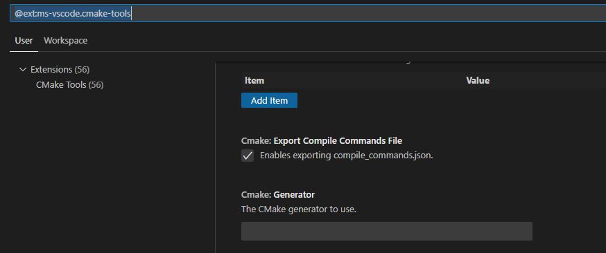

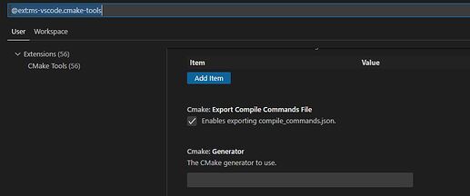

Thank you for your response.
That is the reason why I am asking. I was among the first who used this guide few months ago. So I want to understand the differences because how I wrote above I have installed this on two workstations according to same guide, both are working as expected without the need to fill the generator settings.
Maybe it has to do with other programs installed on the system? Like, if mingw32-make and/or MSVC are present on the computer, it might choose them by default in some circumstances.
Right to te point Jamie, some weeks ago I tryed mbed-cmake and in the toolchain setup wiki you pointed to mingw32-make first as the make tool, I did so, probably it has been the root cause.
Thank you
