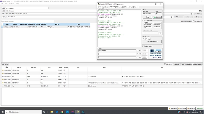

Yes Im serving 1 message at a time. Basically on the web page sends a request to server in every 5 seconds to update a status web page. If I open multiple tabs I think they sends requests asynchronously. Thats where it starts crashing.
I done a test using different terminal softwares. When they works individual no issues.
Here when I stay connected on HERCULES and send data on PACKET SENDER ,mBED returns nothing.Thats correct as well according to my code. When I press disconnect on HERCULES ,then mbed crashes. As you can see I’m just sending 14 characters.
The(size == 536) I had to use, coz If mbed receives more than 536 bytes the size says 536.I think my complete packet is about 700 bytes

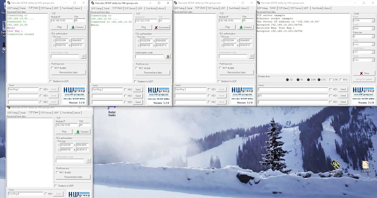

Hi Paul,
Thanks for your information.
I’m working with MBED LPC1768. In my application ,the web server I’m using for some configurations and monitoring of the unit. The the device just connecting to a LAN only.
As you said I just tried following TCP server code without using threads. Still the same issue. Its crashing on if I connect more than 3 connections simultaneously. Even without sending any data to MBED.It works fine with single connection. The srv.listen(5); doesnt make any different .
Here is a video how im tesing the setup.
Thanks
Best Regards
Dan

Hi Dan,
Looking at the video the IP’s look the same 192.168.10.201 ? with your server IP at 192.168.10.50
I maybe wrong but I think you may have to close on that IP before you can connect again on the same IP or perhaps try to set different port numbers, not sure if that will help.
In the real world you would have one connection on one IP and the link ID should relate to the IP address and perhaps resolve down to a port number.
But I’m not an expert here.
Can you try this using 3 different IP’s or if you haven’t already, specify different ports ?
I know I connect in my local network simultaneously but all devices have different IP’s on port 80 simply for ease of connection on a web browser, if you use 80 you don’t have to set the port number in web browser, so hence I use different IP’s on port 80.
Paul
Hi Paul,
Yes I’m using same IP (201) but different source port numbers.You can see that on video .TCP server should work on different source port numbers. I tried 3 different IPs still the same. I think the issue is handling the session layer on ethernet library.
I started MBED and programming just a month ago, still i’m a newbie :slight_smile:
Cheers
Dan
