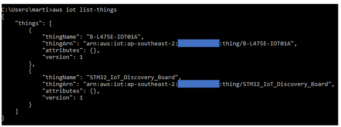

I tried to extract some connectivity info through the AWS Cli. No matter what I seem to do, I can’t find any indication that my AWS Thing has any attached policies:

I would suggest using a desktop MQTT client such as the AWS IoT python SDK to test the policies first. Use the same credentials and the same parameters to see if you can connect from another client. This would help to rule out device related problems and isolate your issue. There are plenty of resources which can guide you through the AWS related issues. If you can connect with another client, try again with the Mbed client and post the results here, maybe we can help afterwards.
