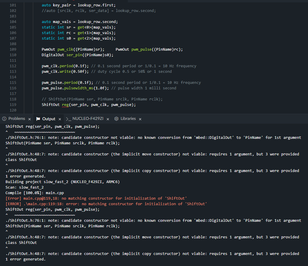

set_to_fast function of above program is giving compile error on one line of code of ShiftOut constructor call.
I need your help in fixing this compile error on line 114 please.
Best regards.
Below screen capture is showing the errors:
Yeah, your code is wrong - object types.
Look these lines of your code
        PwmOut pwm_clk((PinName)srclk);
        PwmOut pwm_pulse((PinName)rclk);
        DigitalOut ser_pin((PinName)ser_data);
        // ShiftOut(PinName ser, PinName srclk, PinName rclk);
        ShiftOut reg(ser_pin, pwm_clk, pwm_pulse);
The comented line tell you the constructor need 3 parametrs of PinName type. And object what you used are PwmOut and DigitalOut. That is what compiler not want accept it.
I am not sure what is the goal but probably
ShiftOut reg((PinName)ser_data, (PinName)srclk, (PinName)rclk);

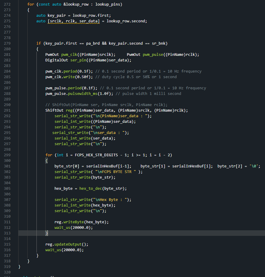

Hi JohnnyK,
Following program is giving
SIGABRT Abnormal termination error.
Can you please help in let me know how to fix this abnormal error?
Thanks and best regards,

Above Abnormal termination error is caused by the following program:
Please let me know of the code line that is causing error and how to fix?
Thanks,

Above writeByte function is called by setHexGPIOpins function of main_lens_fcps.cpp shown below:
void setHexGPIOpins(char* serialInHexBuf, const string inHexBuf )
    char byte_str[3];
    int hex_byte;
    // int i = std::stoi( inHexBuf.substr( 10, 2 ), 0, 16 );
    unsigned long i = strtoul( inHexBuf.substr( 10, 2 ).c_str(), 0, 16 );
    int sr_bnk = ( i >> 6 ) & 1;
    int pa_brd = i & 63;
    serial_str_write("\nSR_BNK : ");
    serial_int_write(sr_bnk);
    serial_str_write("\n");
    serial_str_write("\nPA_BRD : ");
    serial_int_write(pa_brd);
    for (const auto &lookup_row : lookup_pins)
        auto key_pair = lookup_row.first;
        auto [srclk, rclk, ser_data] = lookup_row.second;
        if (key_pair.first == pa_brd && key_pair.second == sr_bnk)
            PwmOut pwm_clk((PinName)srclk);     PwmOut pwm_pulse((PinName)rclk);
            pwm_clk.period(0.1f); // 0.1 second period or 1/0.1 = 10 Hz frequency
            pwm_clk.write(0.50f); // duty cycle 0.5 or 50% or 1 second
            pwm_pulse.period(0.1f); // 0.1 second period or 1/0.1 = 10 Hz frequency
            pwm_pulse.pulsewidth_ms(1.0f); // pulse width 1 milli second
                serial_str_write("\n(PinName)ser_data : ");
                serial_int_write((PinName)ser_data);
               serial_str_write("\nser_data : ");
                serial_int_write(ser_data);
            for (int i = FCPS_HEX_STR_DIGITS - 1; i >= 1; i = i - 2)
                byte_str[0] = serialInHexBuf[i-1];    byte_str[1] = serialInHexBuf[i];  byte_str[2] = '\0';
                serial_str_write( "\nFCPS BYTE STR " );
                serial_str_write(byte_str);
                hex_byte = hex_to_dec(byte_str);
                serial_str_write("\nHex Byte : ");
                serial_int_write(hex_byte);
                reg.writeByte(hex_byte);
                wait_us(20000.0);
            reg.updateOutput();
            wait_us(20000.0);

Below is screen capture image of lines of code from 272 to 320 of setHexGPIOpins function:
I am suspecting, line 311 is either not executing or hex_byte value is either blank (instead of expected 1E (decimal 30) or 1F (decimal 31) ).
I am executing for loop on lines 299 through 313 five times but the value of hex_byte is not being sent by reg.writeByte function of line 311 to DESERIAL of following function:
//Writes a byte to the shift register
void ShiftOut::writeByte(unsigned char byte){
    hasChanged = true;
    for(int i = 0; i<8*REGISTER_CNT; i++){
        DSERIAL = (byte & 0x01<<i)>>i;
        updateRegister();
//    updateOutput();
By debugging I want to find why writeByte function is not working?
