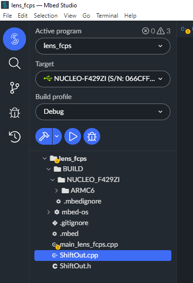

I kept breakpoint on line 48 of ShiftOut::writeByte function
code_lines_01d
I am expecting the cursor to stop on line 48 about five times, so that I can watch value of byte parameter.
But the cursor is not reaching or stopping on line 48 at all.
I am starting debugger by clicking on debug of the following screen capture:
Cursor stopped on line 77 of main function shown below:
I am using the following debug buttons, to break at line 48 of ShiftOut::writeByte function watch value of byte parameter but I am not able to.
code_lines_01g
Can you please let me know some detailed steps along with screen capture images, so that I can make the debugger break on line 48 please?

I am not sure why it stops at the start of the main, I am not so experienced, however when you will press continue, then the debugger will release your program and let you type your hex string input. Next stop will be your break point.
Anyway I am not sure that working correctly. Because when I stepped into function writeByte, there was always a weird byte value like 72 or 73 and later it is out of scope.
But when I print out the byte inside the function using debug printf function as int it is still number 30.
However the output on the pin seems to be inverted, because the byte mask is set for LSB.

It is standard behavior for a number of debuggers to always break on the first line of main. Sometimes they have an option somewhere to turn this off.
