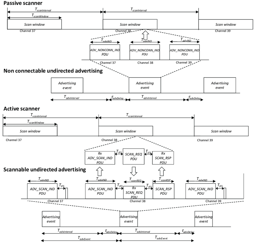

So I had to find out… and came across this useful diagram online.
source: https://www.researchgate.net/figure/Non-connectable-and-scannable-undirected-advertisement-detection-procedure_fig1_323898620
From additional my investigation, I’ve made a new thread;
When the timing for advertising to be active - Mbed OS - Arm Mbed OS support forum
Thanks.
