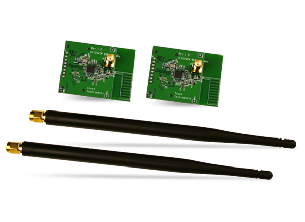

CC1200 Driver
Author: Jamie Smith
Use This To:
Send and receive data using Texas Instruments’ CC1200 (and CC1201) radio transceiver ICs. These radio chips are incredibly flexible, and feature a variety of different configurable frequency bands (from 136MHz-960MHz), radio modulations (ASK, FSK, and OOK), and symbol rates (1Hz-500kHz), as well as a litany of other packet formatting options. The CC1200 automatically handles forming data into packets and checksumming it, and also provides 128 byte FIFOs for data being transmitted and received. So, your processor can let the CC1200 handle the real-time aspect of radio communications and pick up the data later at its leisure. All in all, the CC1200 is a solid option if you want to add RF communications to an existing MCU or board.
Since this radio has so many different configuration settings to set, historically users have been limited to the premade configuration values that TI provides in their SmartRF Studio. However, since RPL needed to experiment with lots of different settings on the CC1200, this driver implements the calculation of all register values from the raw RF settings (such as symbol rate and frequency) that you select. This wasn’t easy, and required us to fight through many vague datasheet register descriptions and calculations (as well as some that were flat-out wrong), but it’s working well now! And thanks to our labor, you can select absolutely any RF configuration supported by the chip.
Note: The CC1200 supports operation as an 802.15.4 transceiver, but RPL hasn’t implemented this functionality because we don’t need it. If you did want to implement this, however, this driver would be a good place to start, and we’re open to contributions!
