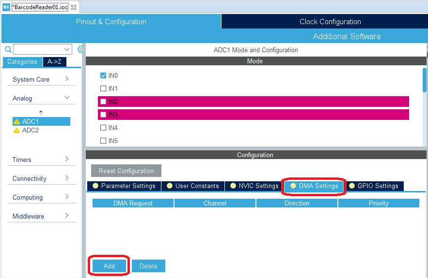

With the STM32CubeIDE it’s quite easy :
  • Open the .ioc file and on the Pinout & Configuration tab open Categories > Analog and select the ADC controller you’d like to use.
  • After selecting the input channel (e.g. IN0) you can configure it as needed (In this case to run in continuous mode.)
  • Select the DMA Settings tab and click on the Add button.
  • Select ADC1 for DMA Request.
  • Set up the DMA transfer direction from peripheral (ADC) to Memory (SRAM), automatic SRAM memory address increment after each transfer and data width.
  • On the NVIC Settings tab enable global interrupt for the DMA1 channel1.
  • Save the .ioc file and let STM32CubeIDE generate the code.
  • Open the main.c file and implement your code to start ADC conversion (e.g. on timer TIM3 Channel 1 tick event) and the code to be executed when the ADC conversion is finished/complete. For example:
