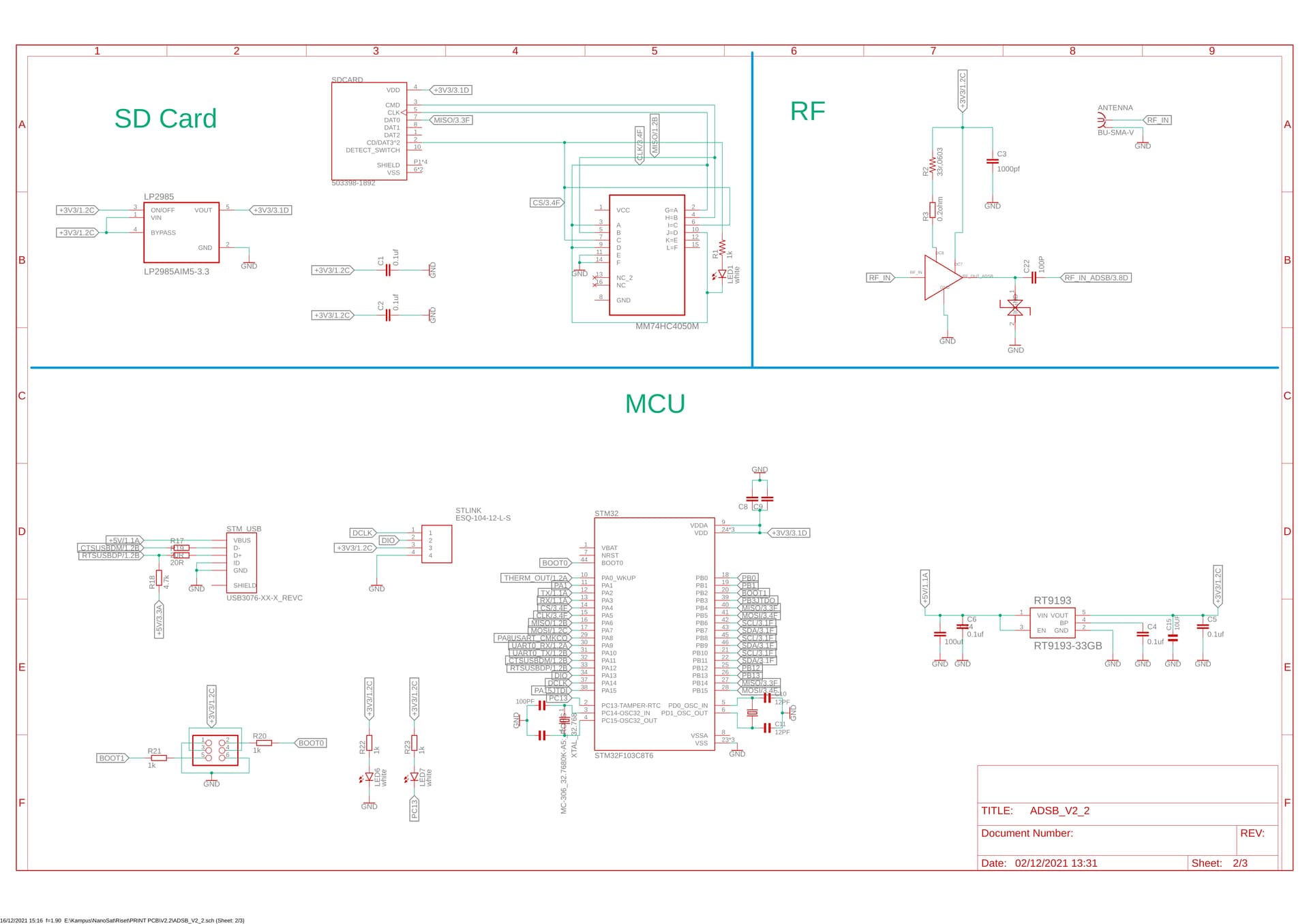

Got Error: "Cannot initialize RTC with LSE" on STM32F103C8T6 Custom Board
I’am working with a custom STM32f103C8T6 board for research, it’s connected to a radio receiver module through uart and SD card module through SPI, basically, i receive a data from the receiver module and save it in the sd card and display it in serial monitor. First, I developed a code that read the data from the receiver module and display it in the serial monitor and it worked, then when i add the sd card part of the code to save the data into it I got an error “Cannot initialize RTC with LSE” (the detail error message is written below the code in this post). i have tested the full code (including the sd card part) in nucleo l432kc board (i connect the radio module and the sd card as well) and it worked just fine. Is there any solution to this problem?
PS. I used the nucleo F103RB platform when compiling in the mbed compiler

below is the error as shown in the terminal,

here is my board schematics,
Hmm, looks like this message is caused by failure to initialize the LSE oscillator (the crystal connected to the OSC32 pins). Why is this only happening now? Using the time() API causes Mbed to try and initialize the real-time clock on the chip, and to drive that it uses the LSE oscillator by default.
I would start by checking out the 32kHz crystal and the associated parts & solder joints on your PCB, maybe this is an assembly problem as the MCU does not seems to be able to get a proper signal from it. If that fails, you could try creating an mbed_app.json like this:
    "target_overrides": {
            "target.lse_available": 0
This will disable use of the LSE oscillator and force use of the internal 32kHz oscillator (LSI) instead.
