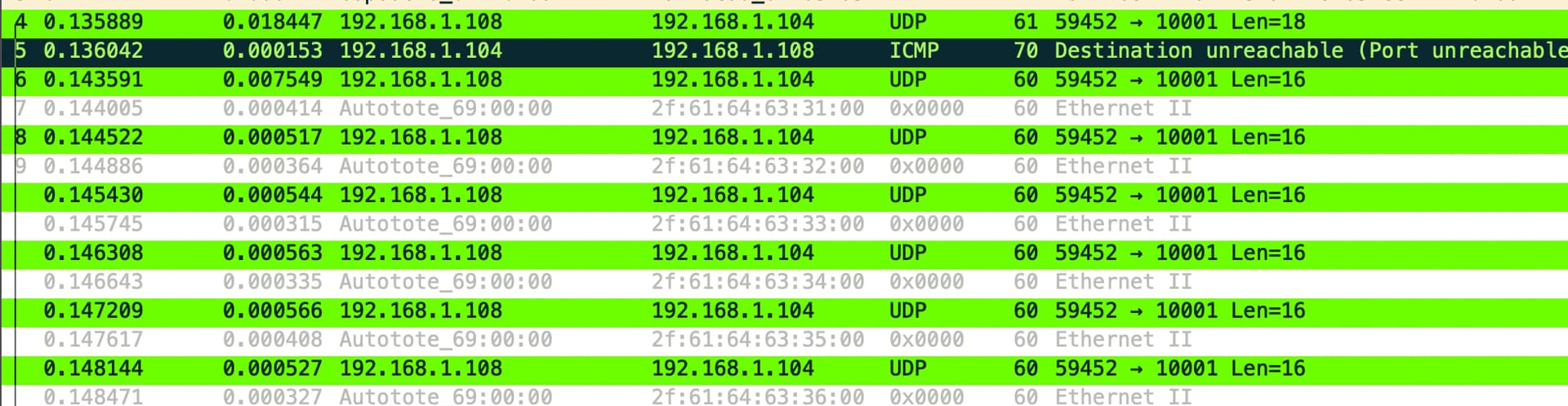

Hello! Using the UIPEthernet by @hudakz I have a problem: more than about 90% of the packets I send over UDP are lost. I have ENC28J60 module, microcontroller with MBED
and UIPEthernet library, I accept UDP data from the computer on ENC28J60 and everything works well, But the situation manifests itself only when I send more than two packets from the computer at the same time (of course, the computer does not send them “simultaneously”, I mean that the packets go one by one close to each other) I checked on other devices and when the computer-to-computer connection via Ethernet, everything works perfectly, but when I connect the computer to my ENC28J60 chip, a problem arises.
As far as I understand, if the microcontroller does not have time to pick up from the ENC28J60 it should be stored in a special memory inside the ENC28J60 and this should solve my problem, but no. Can anyone know what I am doing wrong and what is the mistake? I am attaching a part of the code in which the UDP reception is processed. I am a beginner in development, thank you all for help!
/////the code below runs endlessly in a circle after initializing and opening a socket with the desired port
int size = socketReceive.parsePacket();
    if (size > 0)
      do
        char *data = (char *)malloc(size + 1);
        int len = socketReceive.read(data, size + 1);
        data[len] = 0;
///in this section, things are done with data and everything is ok
        free(data);
      } while ((size = socketReceive.available()) > 0);

Hello Hudakz!
I managed to run your new emac driver in platformio but still have some confusion…
maybe you know why UDP messages can be sent this way?
the screenshot shows UDP messages on the receiving side of the connection, but for some reason, what I send via UDPsocket is sent only the first time, as UDP, and then as some unnamed packet.
I also noticed a strange behavior that if you remove printf from the code below, then no UDP is sent at all.
