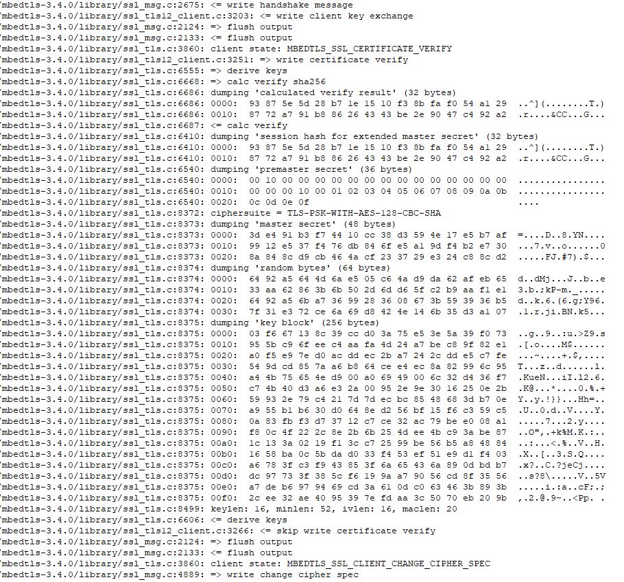

MbedTLS Handshake failing between client & server (v 3.4.0)
I’m trying to develop an application using MbedTLS SSL libraries that encrypts data exchange between client & server using PSK based TLS 1.2.
Turns out that client side is crashing while trying to send the change cipher spec message during TLS handshake.
Crash:
signal 6 (SIGABRT), code -1 (SI_QUEUE), fault addr --------
Call stack:
(mbedtls_ssl_write_handshake_msg_ext.cfi+1752) (BuildId: 063bc231b105d66ece7418b0a7ac9de4)
(mbedtls_ssl_write_change_cipher_spec.cfi+124) (BuildId: 063bc231b105d66ece7418b0a7ac9de4)
(mbedtls_ssl_handshake_client_step.cfi+1912) (BuildId: 063bc231b105d66ece7418b0a7ac9de4)
(mbedtls_ssl_handshake_step.cfi+400) (BuildId: 063bc231b105d66ece7418b0a7ac9de4)
(mbedtls_ssl_handshake.cfi+108) (BuildId: 063bc231b105d66ece7418b0a7ac9de4)
Server times out waiting for the change cipher spec message from the client.
It is crashing on line number 4 in the code below:
1 int mbedtls_ssl_write_handshake_msg( mbedtls_ssl_context *ssl )
2 {
3 int ret = MBEDTLS_ERR_ERROR_CORRUPTION_DETECTED;
4 const size_t hs_len = ssl->out_msglen - 4;
5 const unsigned char hs_type = ssl->out_msg[0];
6
7 MBEDTLS_SSL_DEBUG_MSG( 2, ( “=> write handshake message” ) );
ssl->state is MBEDTLS_SSL_CLIENT_FINISHED and ssl->out_msglen is 1 which is making hs_len as -3.
Is that causing the crash?
Any pointers on missing API calls/discrepancies in the order in which the API calls were made would be greatly appreciated.
I’m sharing the high-level client & server code below. I’ve also attached MbedTLS debug logs for the same.
