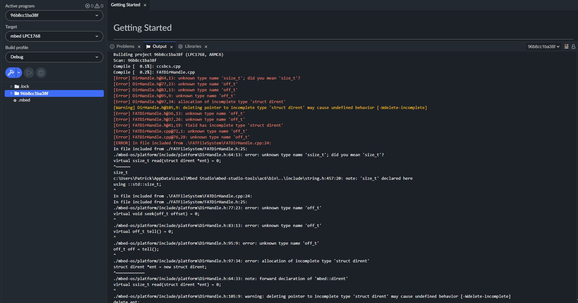

Hi Jamie, these are the error i got so far and it only compiled 0.2% currently.

The errors above are strange, this does not seem to be related to your project but some bad setting of whole project. Try create New empty one or popular Blinky, then copy content (also libraries) of the main from your old project based on the Mbed2. Run compilation and try fix errors. If you will stuck somewhere place the error here I will try to help ASAP.

it might be caused by my attempt to migrate the project. The project folder used to contain mbed.bld and MODSERIAL.lib , I deleted mbed.bld and replaced it with Mbed-os, which i downloaded from mbed website. the content in the MOBSERIAL.lib only has one line, it says MODSERIAL#1df6aeea544d. Please let me know if these info would help you figure out the problem I have.

Maybe just create a new blank Mbed 6 project in Mbed Studio and copy over your code?
Note that you will not need MODSERIAL anymore as this feature is now built into Mbed.
