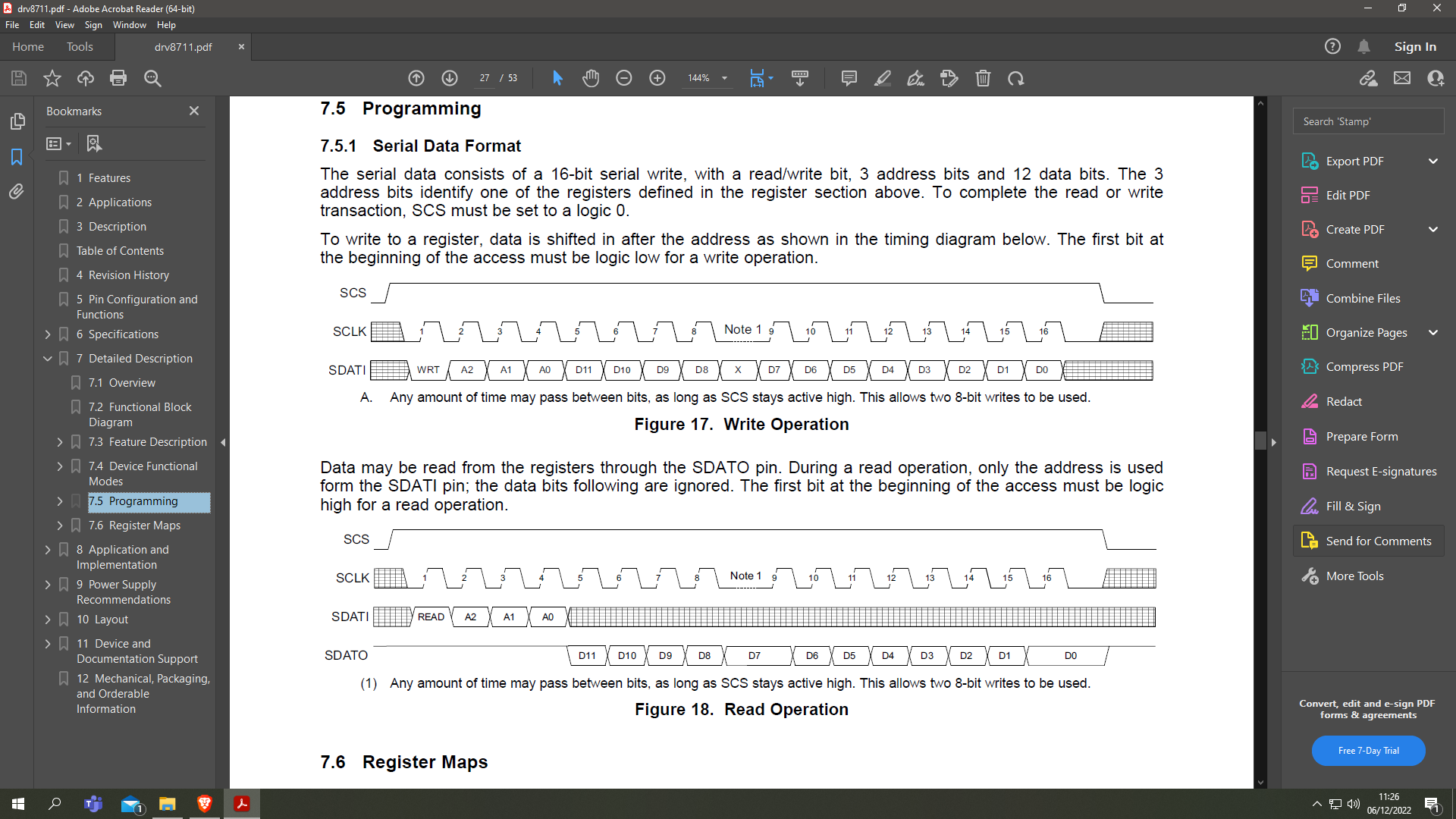

I am getting to grips with MBED and SPI and I seem to have difficulty in reading from slave device registers. I can write to them without issue and confirmed this with a picoscope. However, I get nothing when trying to read from it.
For a little back ground, I am using the DRV8711 stepper motor driver with a LPC1768. the driver uses a 16 bit format with the MSB as the r/w bit (set high to read), followed by a 3 bit address and the remaining 12 bits are instructional. The MISO line also uses a 2K pullup resistor.
Could some one please help me to understand where I could be going wrong and possibly give some advice regarding best practice when programming SPI?

Hi Zoltan,
Thank you for reply.
To read from the device registers, I’ve implemented a seperate function int readReg(int address) which sets the read bit high before sending the command which is a ‘dummy’ command since in this case only the first four bit are needed. (Ive added a screen shot of the data sheet below for clarity). Apologies if i wasn’t clear about the read/write being seperatefunctions, ill make a note in the original post.
Thanks,
Andrew
To read from the device registers, I’ve implemented a seperate function int readReg(int address) which sets the read bit high before sending the command …
I have seen the readReg function. But, as I said in my first post, it does not set the read bit high!
