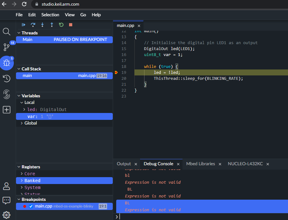

Hi - I’m trying to use the Keil Studio debugger, but while I can manage to set breakpoints, view variabiles, memory, and so, I haven’t figured out yet how to use the “debug console”.
This apparently allows to enter commands, but I cant find proper documentation for that.
I imagined the commands from the uVision command window could apply to the Studio too (Documentation – Arm Developer) but none of them seems to work, always giving an “Expression is not valid”.
Any reference about how to use that debug console. Still, my first aim is at finding the memory map (MAP command could help, if it worked).

Hi @ffxx68 ,
Unfortunately there is no Debugger CLI support in Keil Studio Cloud yet.
