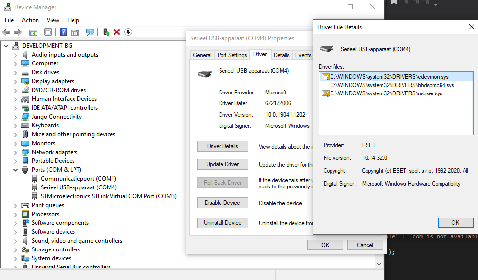

Hi we have a DISCO_L476VG and are working on a COM connection between the board and PC.
It will connect properly to the terminal using i.e. putty. But when we want to connect to the board using C# with the System.IO.Ports package it will not work, resulting in a System.IO.IOException. In C# you can check if it is connected. C# says it is connected to the COM port and tries to send data. But my STM board does not log a connection or the message to the ST-Link COM connection. The connect/disconnect and message logging does work if we connect using terminal.
We think it is a driver issue and have tried several drivers. Some result in C# not crashing, but also not receiving the send data.
The C# code does work on other COM devices and we have tested this properly.
Where can I find the proper drivers for windows 10, or which one should I use from the update driver selection. Are there any known problems with mbed OS and C# perhaps?

According to the picture above you are trying to use COM4 for the communication but you expect to see a log or message over the ST-Link COM connection.
Was the virtual port COM4 on your PC created by a serial-to-USB driver of a dongle connected to a serial port on the DISCO board?

I am using the USBSerial class and have a second USB cable connected on USB USER on the underside of the board. Like I said, I can connect using a terminal i.e. putty or mobaxterm, and thus do not need a external UART to Serial/COM device. When using the same COM connection as I do in mobaxterm it does not work in C#.
Also the logs I talked about I added myself after detecting a device was disconnected by polling USBSerial::connected() or after USBSerial::wait_ready()
I am currently testing using the example on this mbed USBSerial page and the example by microsft.
I modified the mbed example to disable the blocking USBSerial connection so it will just send data and not wait to be connected. Also I added a printf so I know when data is send send.
In the TimeoutException on line 69 of the C# example I added a Console.WriteLine and increased the read and write timeout to 2000ms.
C# is polling data from the COM connection, and I know mbed is at least sending data because I can see it receiving in mobaxterm. Yet still no success on the C# side.
you need to set the DTR signal on the PC side. putty does this, some other terminal programs need also a manual setting of DTR.
Thanks a lot, This solved our problem!
