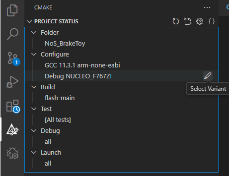

I m trying to program mBED LPC1768 board using mBED CE platform. What I have done is I followed the steps for installation of Visual studio and required extension. I installed CMake and GNU also. But I am getting the error: cannot open source file mbed.h. Kindly help me anyone.
did you already select necessary settings in CMake extension panel? Especially Build variant (Debug NUCLEO_F767ZI in case below).
Point 7 of Project Setup: VS Code · mbed-ce/mbed-os Wiki (github.com)
I followed the same but, the variant(mBED LPC 1768) was not shown in the list.
OK, so the build variant was not set, you can not start CMake and that is the reason of the error. Then go two steps back, point 5. The file cmake-variants.yaml is probably missing in your project or it is not filled correctly.
It should look like

I chose the Upload method as MBED
And now the variant is also showing as Develop + MBED LPC1768. But still it is exit with 1.## cannot open source file mbed.h
This error is I am seeing. And I did not follow step 6 which I did not understand.
In the CMakeLists Text document, at include(mbed-os/tools/cmake/app.cmake), I am seeing the error of “include could not fine requested file”. How to add mbed-os folder to my project?
