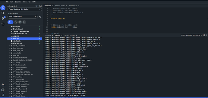

Is there any tutorial on how to generate this AXF file generated by Debug.
When I compile a code in Keil Studio, several files are loaded that I end up not using in my code
Can I disable these loaded libraries?
