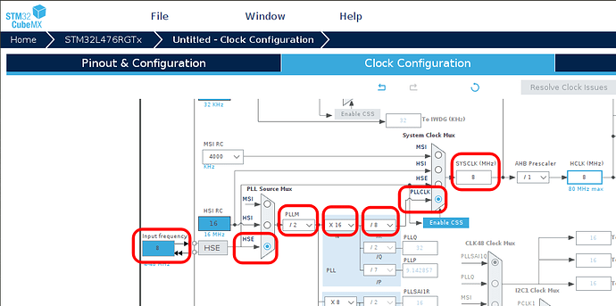

To reduce the system clock frequency you should modify the PLL coefficients in the
/mbed/targets/TARGET_STM/TARGET_STM32L4/TARGET_STM32L476xG/system_clock.c file.
The easiest way to figure out the target values is to use STM’s tool STM32MX, which you can download from the STM website for free.
  • Start a new project by clicking on the Access to board selector button:
STM32MX_01
  • In the part number combo box Slect STM32L476RG:
  • In Categories on the Pinout & Configuration tab click on the RCC (Reset an Clock Control) item and for the High Speed CLock (HSE) select Crystal/Ceramic Resonator.
  • Proceed to the Clock Configuration tab. Make sure the Input frequency is set to 8 (MHz), HSE is selected as input for the PLL block and the PLLCLK is selected as source for the SYSCLK (System Clock).
    Then start to vary the PLLM, PLLN and PLLR coefficients until you get the selected target SYSCLK.
  • Once you have succeeded (see in the picture above), modify accordingly the corresponding PLL coefficients in the file mbed/targets/TARGET_STM/TARGET_STM32L4/TARGET_STM32L476xG/system_clock.c:
#if HSE_VALUE==8000000
    RCC_OscInitStruct.PLL.PLLM              = 2; // VCO input clock = 4 MHz (8 MHz / 2)
#else
#error Unsupported externall clock value, check HSE_VALUE define
#endif
    RCC_OscInitStruct.PLL.PLLN              = 16; // VCO output clock = 64 MHz (4 MHz * 16)
    RCC_OscInitStruct.PLL.PLLP              = 7;
    RCC_OscInitStruct.PLL.PLLQ              = 2;
    RCC_OscInitStruct.PLL.PLLR              = 8;  // PLL clock = 8 MHz (64 MHz / 8)

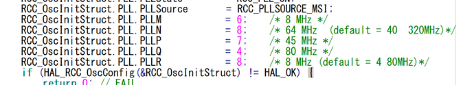

I try to modify “system_clock.c” , but my application stop on creating instance of bufferedserial class.
What I did is as shown below.
  1. Change PLLN value from 40 to 8.
    2.Change PLLR value from 4 to 8.
Do you have any ideas what should I do to use BufferedSerial in addition I did?
Thank you, Soichiro.

  • Why would you like to reduce the system clock from 80 MHz to 8 MHz?
  • Why did you decide to use different settings than advised? Those setting will not produce an 8 MHz system clock.
  • The working speed of peripherals depends on the system clock frequency. To get the desired bit rate of a UART (BufferedSerial) the mbed system software divides the system clock frequency by some predefined set of coefficients. If the system clock is too low than it could happen that the required bit rate cannot be achieved.

  • Why would you like to reduce the system clock from 80MHz to 8 MHz?
    For Reduce Power consumption.
Because the nucleo-L476RG board does not have an external crystal to use HSE.
MSI is used for PLL in default setting of mbedOS, so I tried the configuration with MSI.
I think my setting can produce 8MHz system clock. But this setting did not work.
  • The working speed of peripherals depends on the system clock frequency. To get the desired bit rate of a UART ( BufferedSerial ) the mbed system software divides the system clock frequency by some predefined set of coefficients. If the system clock is too low than it could happen that the required bit rate cannot be achieved.
I asked STM if the 115.2kHz UART work on my settings, (e.g. 8MHz clock, 16 over sampling and so on), and got answer YES.
So I guessed the reason why UART did not work is there are some setting I should do in addition I did.
