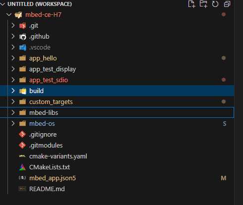

I like to do simple test code and this is well supported by this design, you can simply create multiple projects and use the compiled OS or library stuff. I can recommend a project(s) structure like this:
I start with a simple app_hello with basic blinky and message over UART. Then I’m adding other code in different app_xxx directories.
The CMakeLists.txt is not difficult, for the main:
### add executable (necessary everytime)
#add_executable(${CMAKE_PROJECT_NAME} main.cpp)
add_subdirectory(app_hello EXCLUDE_FROM_ALL)
add_subdirectory(app_test_display EXCLUDE_FROM_ALL)
add_subdirectory(app_test_sdio EXCLUDE_FROM_ALL)
it is like in the mbed-ce-helloworld example, except that you add the app_ subdirectories instead of main.cpp and other sources.
In the app_ directories, the CMakeLists.txt look like e.g. for app_test_sdio with some more sources:
add_executable(test_sdio
    main.cpp
    sdram.cpp
    storage.cpp
target_link_libraries(test_sdio
    mbed-os
    mbed-storage-sdio
    mbed-storage
mbed_set_post_build(test_sdio)
In VSCode, I use the CMakeTools Extension. There you can switch easily between the apps:
For building, there is a icon in the status/command bar.
Hope it helps,
LG
Johannes
