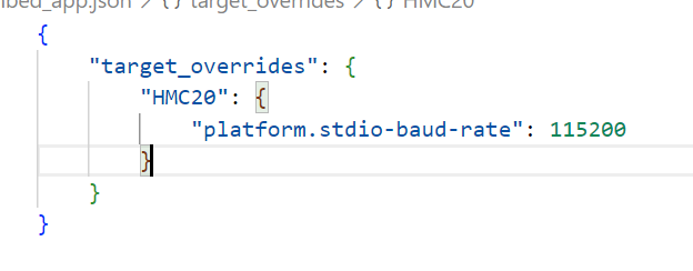

I use my own hardware and retargetted the stdio:
One of the things I think on is that is may be possible that this error data is coming out to a different pin and once in main to the pin where my FTDI is connected on. I will make a variant of the same HW (more generic) where I can better test it. But I will not loose too much time because it’s a non blocking issue. :wink:
Yeah, I remember you have your own board.
If you do not use any retargeting somewhere (like in mbed_app.json) then the output should be PB_6/PB_7
I redirected to PB6/7, in my case the default was different. I remember that in my first trial the serial data was coming out somewhere on the usb pins.
