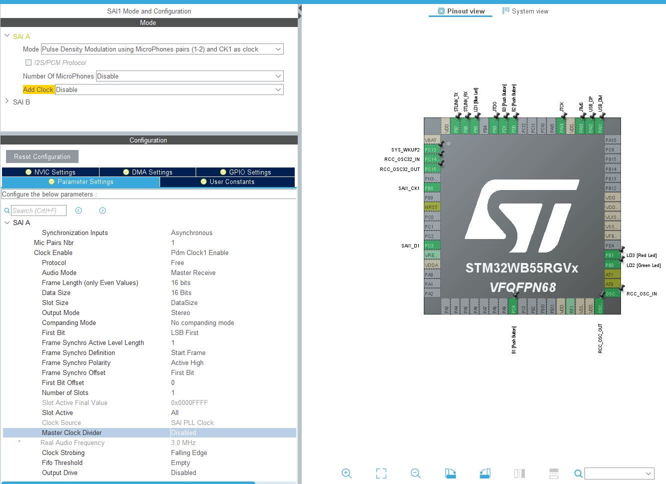

Hi all,
I try implement measuring sound level (SPL). I choose mic MP34DT05-A with PDM and connect to nucleo STM32WB55RG:
  • data of mic connected to SAI_D1_PC3
  • clock od mic connected to SAI1_CK1_PB8
  • used the one mic so input of mic LR connected to GND (or VCC)
To generate code (setting of register) I used described example from section 4.3 of datasheet “Examples of configuration based on STM32CubeMX AN5027” and CubeMX.
and DMA:
Then I got two functions for the comprehensive PDM configuration:

To read mic data I used function:
HAL_SAI_Receive(&hsai_BlockA1, sound_in, 10, 1000);
but it recive error status HAL_ERROR
UART
In mbed I don’t change the clock setting so that may generate the error - I need connect clock to SAI periferia. Mbed doesn’t give API to re-configure that - I don’t want to do it on my own.
Or I made a configuration error.
Someone can help me? I just need only read sound level not record or stream it anywhere.
MbedOS version is - 5.14.1
