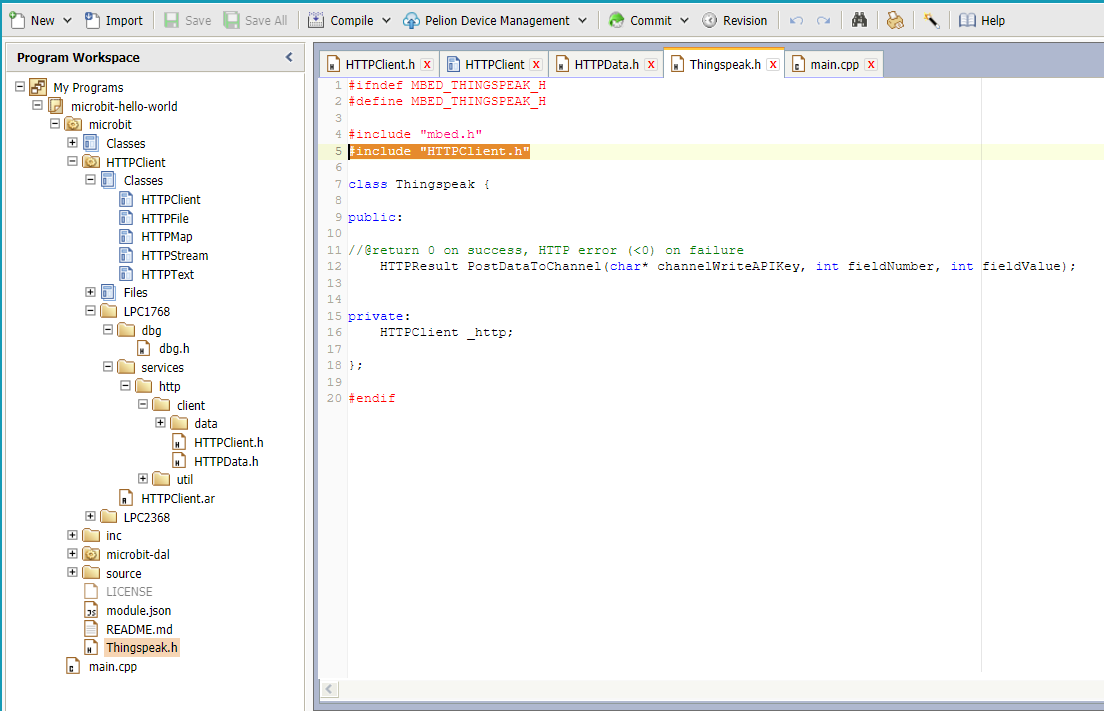

I’m trying to work on a little project with a micro bit using C code in mbed to talk to ThingSpeak. I saw there a function someone created for communication with ThingSpeak but then that needed an HTTPClient.h which I got from the mbed library. Then it needed a .h called #include “core/net.h”. Does anyone know with this h file is or had anyone ever used the ThingSpeak.c or ThingSpeak.h created by [ Reza Mashayekhi]?
This is the HTTPClient.h asking for the #include “core/net.h”
This is the ThingSpeak.H with the HTTPClient.h

You probably mixing libraries together or something similar. I see in your tree this - HTTPclient->LPC1768…
The "core/net.h" probably come from here and probably it will be only for LPC targets and it will be unsusable for microbit.
Probably you need this one
Edit: HTTPClient - mbed HTTP client | Mbed
