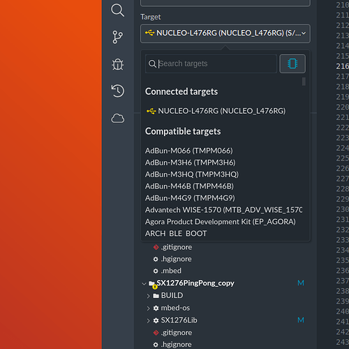

Thanks for the prompt response. I am using mbed studio on linux(ubuntu 18.04) and when I connect the target, the USB icon is yellow in the target selection box.
Is there any follow up on this - I have updated the drivers per the link and still do not have active debug capability - my indicator is yellow also.
