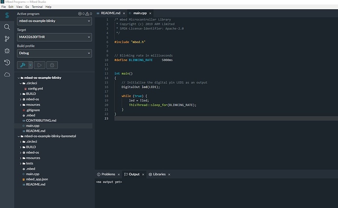

I am using the MAX32630FTHR and trying to get a debug session started within Mbed Studio. I can build the project but I am not able to run or debug the program to the device. The “play” and “debug” icons are not enabled.

Below I am showing the screen in Mbed studio where I can build the project and the target is coming up correctly (MAX32630FTHR) but I don’t have the play or debug option.

I tried with the max32625pico_daplink.bin image and Mbed studio then popped up a window that a probe was detected and asked if I wanted to configure the probe. But when I open the example project up I don’t see the play or debug icon being enabled.
I am trying to load the mbed-os-example-blinky to just try to program and blink an LED.

I downloaded max32625pico_max32630fthr_if_crc.bin firmware (interface version 0254) and then burned that on to the PICO board in MAINTENANCE mode.
To get to that mode you have to hold down the button on the PICO board while you plug it into your computer, burn the FW, unplug from the computer, connect PICO to the FTHR, connect both to the computer.
It should be fine that way, otherwise you might have a broken PICO.
