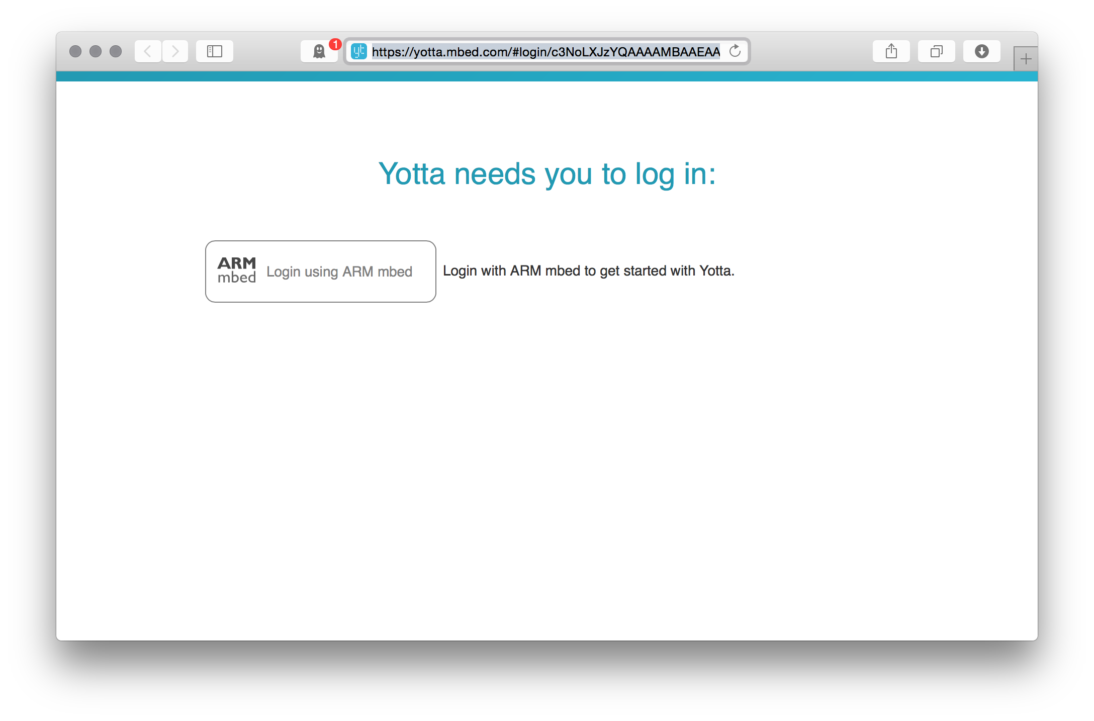

HI I am trying to build the blinky LED example and i get prompted at the build stage to “press enter to continue” and “your browser will open to complete the login”. I get a redirect to the yotta repo but never a login prompt or successful login? The process then times out and fails. I installed using the windows msi. Could anyone advise, there is no mention of a login on the tutorial. Thanks!
@assimilatesystems yotta will also display the URL that it opens on the command line – could you try pasting that into a browser manually, and then see where the browser gets redirected to? You should end up on a page that looks like this, with a URL starting yotta - build better software
If the URL is correct but the page isn’t working, please could you confirm which browser and OS you’re using, as it’s possibly a browser compatibility problem with the website.

Hi @jamcro01 Yes it works if I paste it in, im using Chrome on windows 10. Thanks for the help

@jamcro01 Works perfectly
