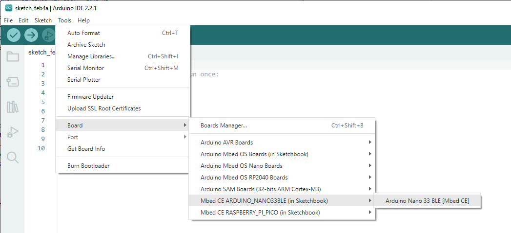

Another thing that’s happened lately is I’ve spoken a bit with Martino Facchin from Arduino – he’s one of the devs responsible for maintaining the Mbed OS Arduino core and its giant pile of patches that Arduino couldn’t merge into mainline Mbed. I talked to him about Mbed CE, and he said that Arduino could be interested in providing Mbed CE as a core option through Arduino IDE! However, they do not have much dev time to spare, so we’d have to do the work of formatting Mbed as an arduino core and creating the correct index files to make it available on the Arduino package index. I managed to complete the first half of that job here. And it DOES work! I’m able to use the generated core files with Arduino IDE to compile & upload Mbed CE projects in one step!
This is pretty cool because it means there’s a much easier development environment option available if people want to use Mbed CE for Arduino boards without going through the manual setup. Also, since Arduino IDE can work with OpenOCD upload methods, there’s no reason we couldn’t add virtually every Mbed board to the Arduino IDE over time.
The remaining part, though, is that in order for the Arduino people to list us in the package index, we need to create a CI job which generates a package.json file and hosts it and the package files via some sort of permanent storage. Github Pages has been suggested as a possible option. The template package.json is here and Arduino pointed me to this ESP32 script which does something similar to use as a reference. Unfortunately I am not a web developer so this is a bit out of my comfort zone… I’d really appreciate if someone could take this on.
