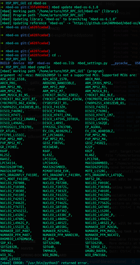

I mean the last supported version for MAX32620HSP
You can see in my terminal screenshot and text below.
➜  mbed-os git:(35fa909641) mbed update mbed-os-6.1.0
    [mbed] Working path "/home/arturo/HSP_RPC_GUI/mbed-os" (library)
    [mbed] Program path "/home/arturo/HSP_RPC_GUI"
    [mbed] Updating library "mbed-os" to branch/tag "mbed-os-6.1.0"
    [mbed] Updating reference "mbed-os" -> "https://github.com/ARMmbed/mbed-os/#a6207cadad0acd1876f436dc6baeddf46c42af06"
    ➜  mbed-os git:(a6207cadad)
➜  mbed-os git:(a6207cadad) cd ..
➜  HSP_RPC_GUI ls
BUILD  device  HSP  mbed-os  mbed-os.lib  mbed_settings.py  __pycache__  USBDevice  USBDevice.lib
➜  HSP_RPC_GUI mbed compile
[mbed] Working path "/home/arturo/HSP_RPC_GUI" (program)
argument -m/--mcu: MAX32620HSP is not a supported MCU. Supported MCUs are:

[mbed] ERROR: "/usr/bin/python3" returned error.
       Code: 2
       Path: "/home/arturo/HSP_RPC_GUI"
       Command: "/usr/bin/python3 -u /home/arturo/HSP_RPC_GUI/mbed-os/tools/make.py -t GCC_ARM -m MAX32620HSP --source . --build ./BUILD/MAX32620HSP/GCC_ARM"
       Tip: You could retry the last command with "-v" flag for verbose output

[DEBUG] Output:                  from ./USBDevice/USBSerial/USBSerial.h:22,
[DEBUG] Output:                  from ./HSP/main.cpp:39:
[DEBUG] Output: ./mbed-os/platform/toolchain.h:23:2: warning: #warning toolchain.h has been replaced by mbed_toolchain.h, please update to mbed_toolchain.h [since mbed-os-5.3] [-Wcpp]
[DEBUG] Output:    23 | #warning toolchain.h has been replaced by mbed_toolchain.h, please update to mbed_toolchain.h [since mbed-os-5.3]
[DEBUG] Output:       |  ^~~~~~~
[DEBUG] Output: In file included from ./HSP/main.cpp:39:
[DEBUG] Output: ./USBDevice/USBSerial/USBSerial.h: In constructor 'USBSerial::USBSerial(uint16_t, uint16_t, uint16_t, bool)':
[DEBUG] Output: ./USBDevice/USBSerial/USBSerial.h:59:203: warning: 'mbed::FunctionPointerArg1<R, void>::FunctionPointerArg1(R (*)()) [with R = void]' is deprecated: FunctionPointer has been replaced by Callback<void()> [since mbed-os-5.1] [-Wdeprecated-declarations]
[DEBUG] Output:    59 |     USBSerial(uint16_t vendor_id = 0x1f00, uint16_t product_id = 0x2012, uint16_t product_release = 0x0001, bool connect_blocking = true): USBCDC(vendor_id, product_id, product_release, connect_blocking){
[DEBUG] Output:       |                                                                                                                                                                                                           ^
[DEBUG] Output: In file included from ./mbed-os/drivers/SPI.h:32,
[DEBUG] Output:                  from ./mbed-os/mbed.h:81,
[DEBUG] Output:                  from ./HSP/main.cpp:34:
[DEBUG] Output: ./mbed-os/platform/FunctionPointer.h:70:5: note: declared here
[DEBUG] Output:    70 |     FunctionPointerArg1(R (*function)() = 0)
[DEBUG] Output:       |     ^~~~~~~~~~~~~~~~~~~
[DEBUG] Output: ./USBDevice/USBSerial/USBSerial.h: In member function 'void USBSerial::attach(void (*)())':
[DEBUG] Output: ./USBDevice/USBSerial/USBSerial.h:134:27: warning: 'void mbed::Callback<R()>::attach(R (*)()) [with R = void]' is deprecated: Replaced by simple assignment 'Callback cb = func [since mbed-os-5.4] [-Wdeprecated-declarations]
[DEBUG] Output:   134 |             rx.attach(fptr);
[DEBUG] Output:       |                           ^
[DEBUG] Output: In file included from ./mbed-os/rtos/Thread.h:29,
[DEBUG] Output:                  from ./mbed-os/rtos/rtos.h:30,
[DEBUG] Output:                  from ./mbed-os/mbed.h:37,
[DEBUG] Output: ./mbed-os/platform/Callback.h:273:10: note: declared here
[DEBUG] Output:   273 |     void attach(R (*func)()) {
[DEBUG] Output: In file included from ./HSP/System/Peripherals.h:46,
[DEBUG] Output:                  from ./HSP/main.cpp:42:
[DEBUG] Output: ./mbed-os/features/FEATURE_BLE/ble/BLE.h: In member function 'ble_error_t BLE::disconnect(Gap::DisconnectionReason_t)':
[DEBUG] Output: ./mbed-os/features/FEATURE_BLE/ble/BLE.h:1049:39: warning: 'virtual ble_error_t Gap::disconnect(Gap::DisconnectionReason_t)' is deprecated: Use disconnect(Handle_t, DisconnectionReason_t) instead. [-Wdeprecated-declarations]
[DEBUG] Output:  1049 |         return gap().disconnect(reason);
[DEBUG] Output:       |                                       ^
[DEBUG] Output: In file included from ./mbed-os/features/FEATURE_BLE/ble/BLE.h:21,
[DEBUG] Output:                  from ./HSP/System/Peripherals.h:46,
[DEBUG] Output: ./mbed-os/features/FEATURE_BLE/ble/Gap.h:1052:25: note: declared here
[DEBUG] Output:  1052 |     virtual ble_error_t disconnect(DisconnectionReason_t reason) {
[DEBUG] Output: ./HSP/main.cpp: At global scope:
[DEBUG] Output: ./HSP/main.cpp:115:12: error: 'BLE ble' redeclared as different kind of entity
[DEBUG] Output:   115 | static BLE ble;
[DEBUG] Output: In file included from ./mbed-os/features/FEATURE_BLE/ble/BLETypes.h:23,
[DEBUG] Output:                  from ./mbed-os/features/FEATURE_BLE/ble/Gap.h:20,
[DEBUG] Output:                  from ./mbed-os/features/FEATURE_BLE/ble/BLE.h:21,
[DEBUG] Output: ./mbed-os/features/FEATURE_BLE/ble/SafeEnum.h:23:11: note: previous declaration 'namespace ble { }'
[DEBUG] Output:    23 | namespace ble {
[DEBUG] Output: ./HSP/main.cpp:118:19: error: expected primary-expression before ')' token
[DEBUG] Output:   118 | HspBLE hspBLE(&ble);
[DEBUG] Output:       |                   ^
[DEBUG] Output: ./HSP/main.cpp: In function 'int main()':
[DEBUG] Output: ./HSP/main.cpp:176:27: error: expected primary-expression before ')' token
[DEBUG] Output:   176 |   Peripherals::setBLE(&ble);
[DEBUG] Output:       |                           ^
[DEBUG] Output: ./HSP/main.cpp:275:10: error: expected primary-expression before '.' token
[DEBUG] Output:   275 |       ble.waitForEvent();
[DEBUG] Output:       |          ^
Traceback (most recent call last):
  File "/home/arturo/MbedPrograms/HSP_BULLS/mbed-os/tools/make.py", line 282, in <module>
    bin_file = build_project(test.source_dir, build_dir, mcu, toolchain,
  File "/home/arturo/MbedPrograms/HSP_BULLS/mbed-os/tools/build_api.py", line 590, in build_project
    objects = toolchain.compile_sources(resources, resources.inc_dirs)
  File "/home/arturo/MbedPrograms/HSP_BULLS/mbed-os/tools/toolchains/__init__.py", line 977, in compile_sources
    return self.compile_seq(queue, objects)
  File "/home/arturo/MbedPrograms/HSP_BULLS/mbed-os/tools/toolchains/__init__.py", line 988, in compile_seq
    self.compile_output([
  File "/home/arturo/MbedPrograms/HSP_BULLS/mbed-os/tools/toolchains/__init__.py", line 1145, in compile_output
    raise ToolException(_stderr)
tools.utils.ToolException: In file included from ./USBDevice/USBDevice/USBHAL.h:24,
                 from ./USBDevice/USBDevice/USBDevice.h:24,
                 from ./USBDevice/USBSerial/USBCDC.h:27,
       Code: 1
       Path: "/home/arturo/MbedPrograms/HSP_BULLS"
       Command: "/usr/bin/python3 -u /home/arturo/MbedPrograms/HSP_BULLS/mbed-os/tools/make.py -t GCC_ARM -m MAX32620HSP --source . --build ./BUILD/MAX32620HSP/GCC_ARM -v"
I tried to go further versions but I got the same result.
