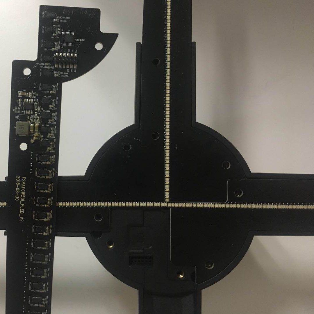

I have been looking into an application involving LEDs physically moving in a scan pattern, similar to the “Holographic LED Fans” being marketed, which use beween 142 and 512 close packed 2mm LEDs to generate simple photo images.
Updating the LED color with each position change, at a rate near the PWM rate would result in significant color inaccuracy do to the asynchronous PWM clock these LEDs use.
The solution may require either a single PWM cycle per color update (eliminating the standard self sustaining light output), or an external PWM clock input enabling synchronization of the mechanical scan position & color changes with PWM cycles.
The single PWM pulse on color updates mode could be enabled by a special code passed in the spare 3 bits of the global dimming setting.
Such a special purpose variation could eliminate outboard driver chips being used with simple RGB LEDs shown the photo. This could speed product design variations.
LED Fan blades anddrivers.
