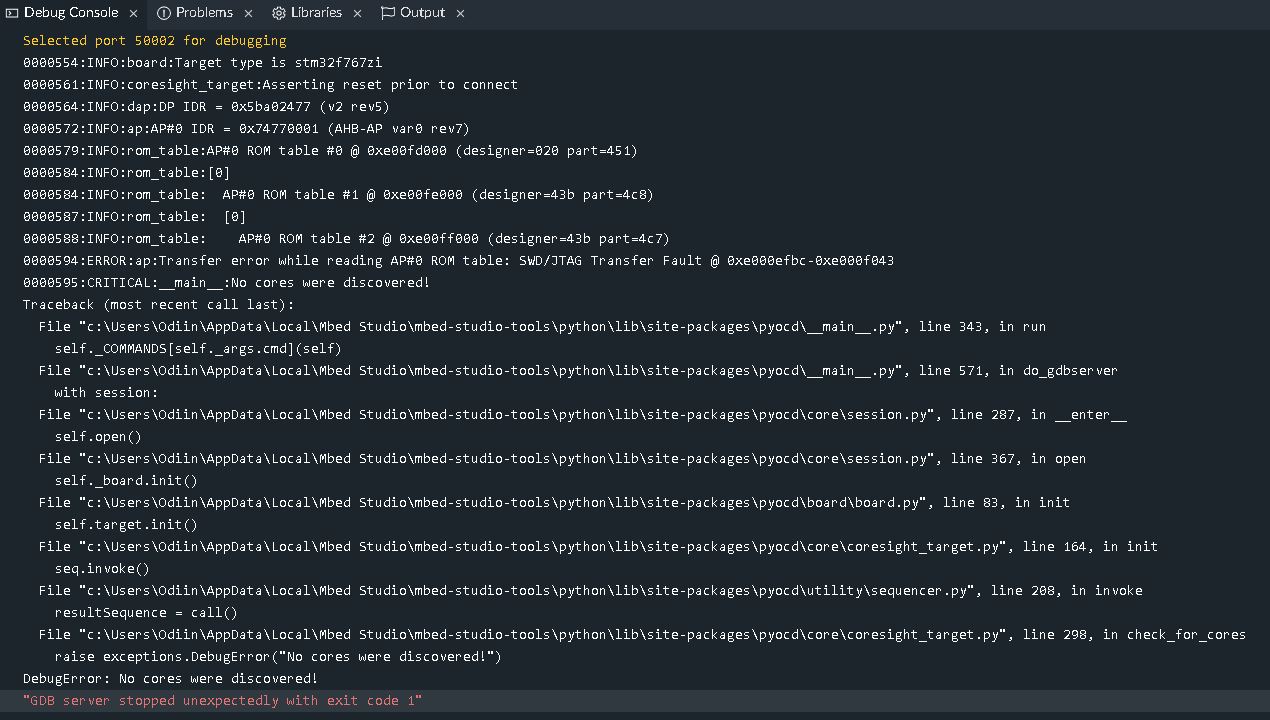

  • MbedStudio and Nucleo-F767ZI - In this post from this January exist an information about an issue with the Debugging with the Nucleo in the MbedStudio.
    After more than 2 months no update, no solution.

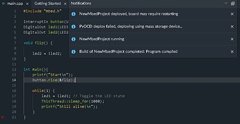

    Also an another new issue is here because during load a program from MbedStudio to the board, the St-link one time flashes with orange color and after is flash of program complete, the LD4 of St-Link stay light with that orange color, deploy failed but the program run. That never occured with the online compiler on the same version of MbedOS(5.15.1) or with Nucleo-F429 on both tools.
Manual: LED is ORANGE: ST-LINK/V2 communication with the target has failed.
I use Windows10 Pro, full updated MbedStudio 0.9.1 and ST-link firmware (V2.J35.M26)

  • MbedStudio and Nucleo-F767ZI - Tools we are using in Mbed Studio do not support out of the box debugging for this board. We are however extending the list of boards that can be debugged by using CMSIS | CMSIS Packs – Arm Developer. Unfortunately, not all packs work correctly with our tools yet. You can find the list of supported boards here: Development boards | Mbed . It is still possible for a board to be debuggable in Studio even if it is not on this list. We are also working on adding debug support to more boards.

Hi Arek,
Thank you for your fast response.
I apologize, I probably missed that migrate of supported targets to the Platforms tree.
I was confused because the Mbed Studio no longer show after the board is connected “that board is not supported” and the Debug button is active, which was not before.
