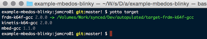

Once you’ve linked it, you can use yotta target <your target's name> to select it.
If you type yotta target it should then show up with a green arrow like this:
Which illustrates it has been successfully linked in to your application, and will be used when you yotta build.
