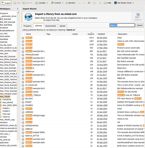

Bin file generated by keil
Imported from mbed online compiler to keil studio.
When importing, an mbed-os version error occurred, so I updated to version 5.15.9 and the error disappeared.
The error went away, so I built and ported the bin file to the device(HEXIWEAR).
When I run it, nothing appears on the screen.
Just in case, after compiling with the online compiler as it is, porting the bin file and running it works fine.
What should I do?

When importing mbed-os in the online compiler, the version is not listed separately.
I’ll have to try the way to check it in keil studio output.
That is not correct way how to do that.
You have to right click on mbed-os and chose Revisions..., then chose a MbdOS version (tag with 5.15.9), again right click and select Switch working...
Oh! Thanks to you, I changed the version and compiled and ported it.
It’s the same phenomenon that the device screen doesn’t open at all.
After changing the version to 5.1.4 in keil studio and porting the bin file, it works properly.
